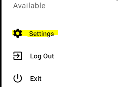

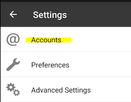

If the issue is determined to be DNS, there is an available work around. Each account allows the configuration of "Custom DNS" servers (up to 3).

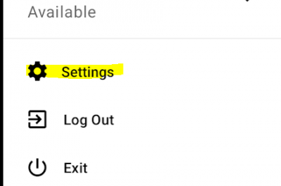

Open the application Menu in the top left.

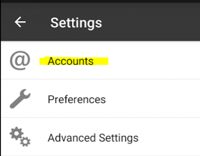

Select "Settings".

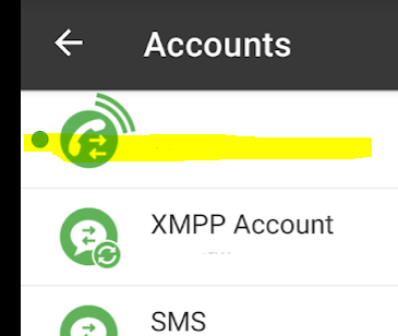

Select "Accounts".
Select the SIP account (it should be the top most account).

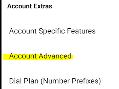

Scroll down and select "Account Advanced".

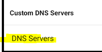

Scroll down and select "DNS Servers".

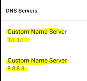

Enter 1.1.1.1 for the first "Custom Name Server" , and 8.8.8.8 for the second "Custom Name Server."
Select the check mark or tick to save.
